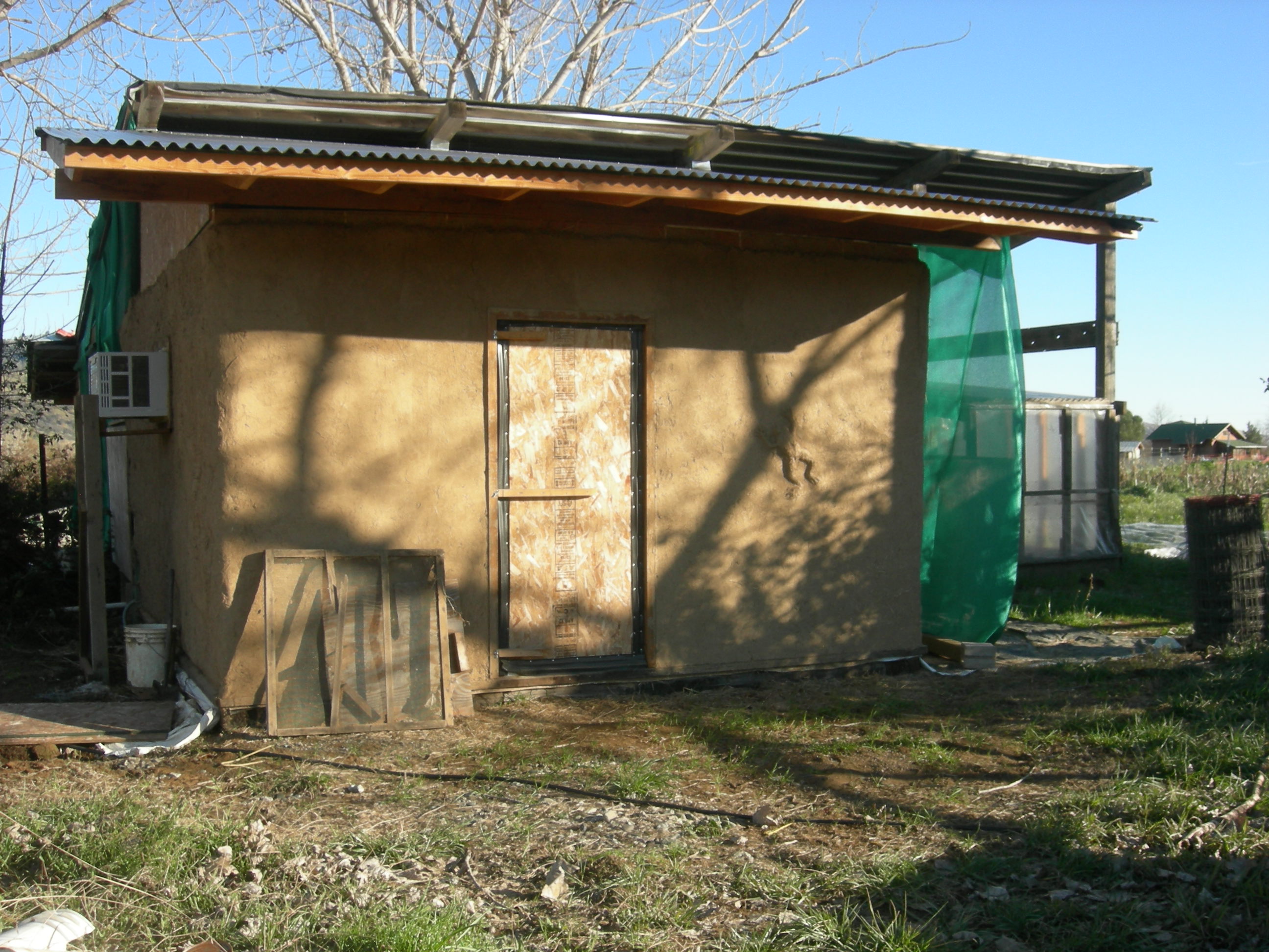

Hi there. I built a 10x10 strawbale cooler for under $2000 (including a metal roof and used coolbot), and have been using it for a year and half now, and it works great. A 10x10 pre-fab cooler is at least $5000, so strawbale is a really economical, efficient and fun way to go. I just put together a poster describing it for the Farm Hack event in Davis yesterday and will be posting it up on this site as soon as I figure how.
